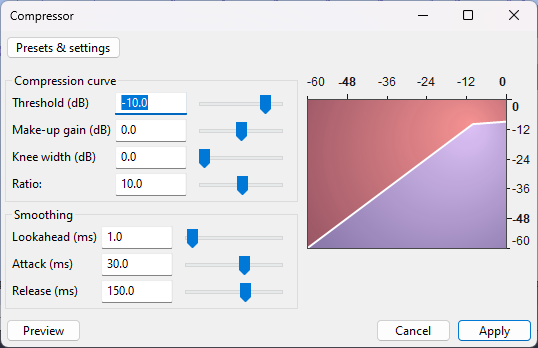

This graph shows the input level along the top (horizontal axis) and the output level scale on the right (vertical axis) to illustrate the dynamic range compression effect. The graph will change as you adjust the Threshold, Ratio, Make-Up Gain and Knee Width sliders, reflecting those settings. The graph does not reflect changes in any of the other controls, although they all affect how the audio sounds after applying the effect.
In the example above, the graph shows a threshold of -10.0 dB and a compression ratio of 10:1. You can read off the graph how signals will be affected:
* A signal coming in at -36 dB will come out as -36 dB - no compression is applied as it is below the threshold.
* A signal coming in at 0dB will come out as -9dB - the input is 10dB above the threshold, and the compression ratio is of 10:1, so the 10dB excess will become only 1.\
  If you wanted to make up for the lost volume, you could now add make-up gain to push the graph upwards.

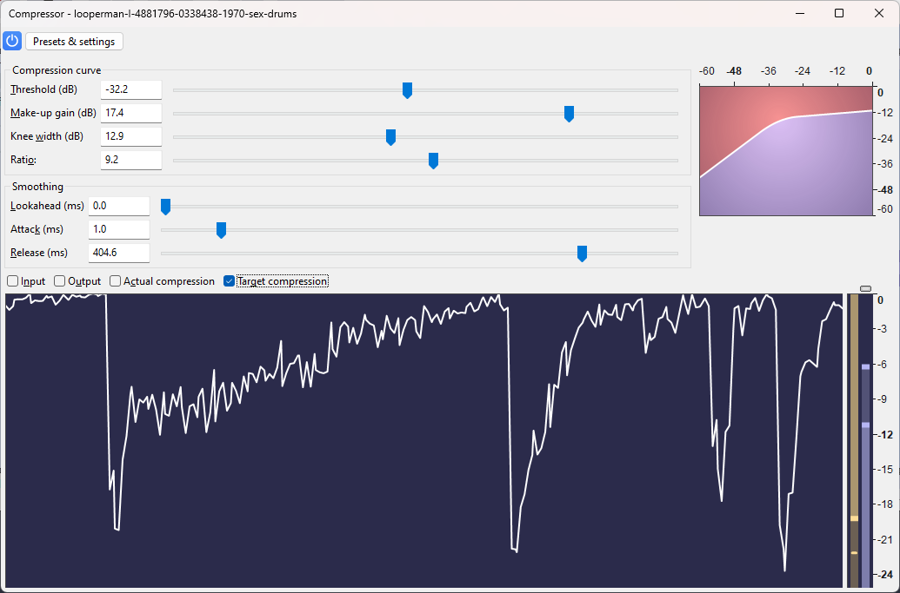

In realtime use there is a graph which enables you to see what the Compressor actually is doing and how it is responding to the parameter setting changes that you make in realtime.

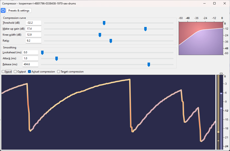

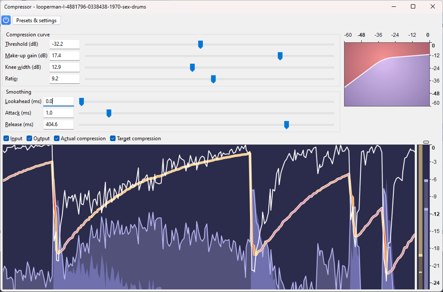

| All elements       | All elements toggled on                                                                           | [![Compressor RT with graph 3-6-0.png](https://manual.audacityteam.org/m/images/9/9d/compressor_rt_with_graph_3_6_0.png)](https://alphamanual.audacityteam.org/man/File:Compressor_RT_with_graph_3-6-0.png) \|                                                           |

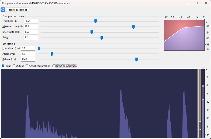

| Input              | the level (short-time peak value) of the input                                                    | [![Compressor RT with graph 3-6-0 - input.png](https://manual.audacityteam.org/m/images/6/6d/compressor_rt_with_graph_3_6_0_input.png)](https://alphamanual.audacityteam.org/man/File:Compressor_RT_with_graph_3-6-0_-_input.png)                                        |

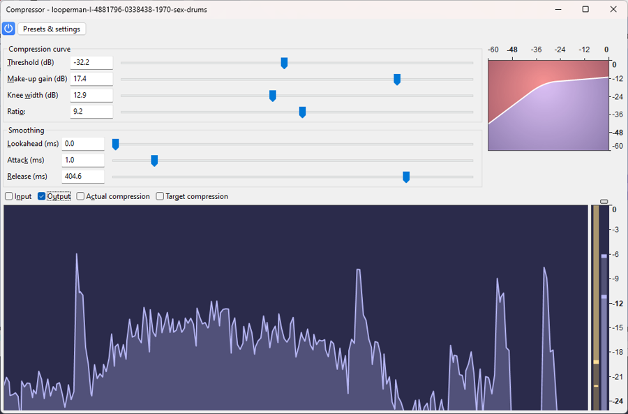

| Output             | the level (short-time peak value) of the output                                                   | [![Compressor RT with graph 3-6-0 - output.png](https://manual.audacityteam.org/m/images/b/ba/compressor_rt_with_graph_3_6_0_output.png)](https://alphamanual.audacityteam.org/man/File:Compressor_RT_with_graph_3-6-0_-_output.png)                                     |
| Actual compression | <p>the compression gain applied to the input<br>(not taking make-up gain into account)</p>        | [![Compressor RT with graph 3-6-0 - actual compression.png](https://manual.audacityteam.org/m/images/c/ce/compressor_rt_with_graph_3_6_0_actual_compression.png)](https://alphamanual.audacityteam.org/man/File:Compressor_RT_with_graph_3-6-0_-_actual_compression.png) |
| Target compression | <p>the compression gain that would be applied to the input<br>if it weren't for the smoothing</p> | [![Compressor RT with graph 3-6-0 - target.png](https://manual.audacityteam.org/m/images/2/27/compressor_rt_with_graph_3_6_0_target.png)](https://alphamanual.audacityteam.org/man/File:Compressor_RT_with_graph_3-6-0_-_target.png)                                     |
Looking at the graph with both target and actual compression toggled at may be helpful to understand the smoothing:
![Compressor RT with graph 3-6-0 - target vs actual.png](https://manual.audacityteam.org/m/images/e/e5/compressor_rt_with_graph_3_6_0_target_vs_actual.png)When the actual compression line is above the target, the target compression gets a red inline. This is to symbolize an "overshoot" situation: the actual compression line is converging towards the target downwards, but in the meantime, the output level is above the mapping specified by the compression curve settings.
Conversely, a purple inline symbolizes an "undershoot" situation, during which there is more compression added than necessary for the input level to be mapped as per the compression curve settings. At that moment, the output level can be seen as though it were in lower, the purple area of the compression curve graph.

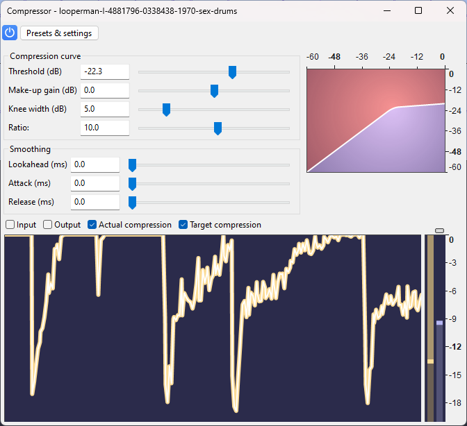

This is how it could look like if all smoothing parameters were set to zero:
![Compressor RT with graph 3-6-0 - target vs actual when equal.png](https://manual.audacityteam.org/m/images/6/6f/compressor_rt_with_graph_3_6_0_target_vs_actual_when_equal.png)
The target compression line is exactly on the actual compression line.
