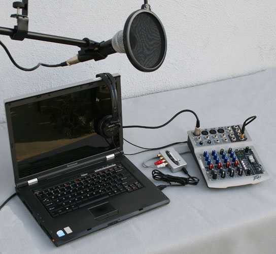

If possible turn off fans or machines while you're presenting. And yes, we understand the contradiction of needing to watch the Audacity screen, remove the noisy computer from your room and keep the computer one USB cable away from your USB microphone all at the same time.
People have done it by extending the keyboard, mouse and monitor outside their studio, but you are warned against extending a USB cable, particularly with audio (or video) production.

I don't know of any easy, foolproof way to permanently fix a USB microphone once you have the whine sound. The most likely fix is change the computer. ACX did it by not using a USB microphone. They used a very high quality analog microphone plugged into a stable USB interface.
