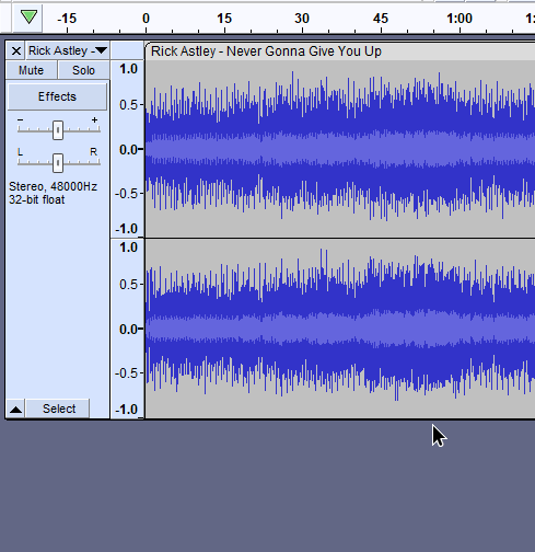

<div><figure><img src="https://2905281570-files.gitbook.io/~/files/v0/b/gitbook-x-prod.appspot.com/o/spaces%2FEnNXGrLkN0pXlkzzS7cM%2Fuploads%2FIaoihysFqrJsTFRHrj7F%2Faudacity_U6xn9MIqiL.png?alt=media&amp;token=77e0e89d-62d2-4475-9e9b-a0b7e0253784" alt="Click the Effects button or press the E key to activate the realtime effects panel"><figcaption><p>1 Click the <strong>Effects</strong> button or press the <strong>E</strong> key to activate the realtime effects panel</p></figcaption></figure> <figure><img src="https://2905281570-files.gitbook.io/~/files/v0/b/gitbook-x-prod.appspot.com/o/spaces%2FEnNXGrLkN0pXlkzzS7cM%2Fuploads%2FXI8nv2FpVavaRMWf3ibE%2Faudacity_7WW2IhXa52.png?alt=media&amp;token=651ff7e9-7c55-4b10-887d-2ecde219341d" alt="Clck Add effect to display the list of available effects"><figcaption><p>2 Click <strong>Add effect</strong> to display the list of available effects</p></figcaption></figure></div>
