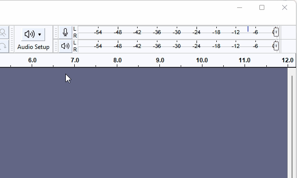

If you see the meter next to the track stay close to the bottom, and barely see the waveform move at all, you likely are recording too quietly. Turn up your mic, or move closer to it. You can also raise the volume afterwards by amplifying it with the Amplify effect. \
![](https://2905281570-files.gitbook.io/~/files/v0/b/gitbook-x-prod.appspot.com/o/spaces%2FEnNXGrLkN0pXlkzzS7cM%2Fuploads%2FZ3gAtdccFtjitogGgr2L%2Fimage.png?alt=media\&token=e35cc5c2-79e2-4fde-b907-5bb739024eb3)
If you click on the microphone button in the toolbar, you can see a meter with decibel markings. Typically the ideal range for your recording to sit at is at -18 to -12 dB, if you're speaking normally.\ <img src="https://2905281570-files.gitbook.io/~/files/v0/b/gitbook-x-prod.appspot.com/o/spaces%2FEnNXGrLkN0pXlkzzS7cM%2Fuploads%2FLmRnzDRCx4SmhjuHkuLM%2Fimage.png?alt=media&amp;token=d95f6747-0496-4428-a6c0-30faab76fa27" alt="" data-size="original">
